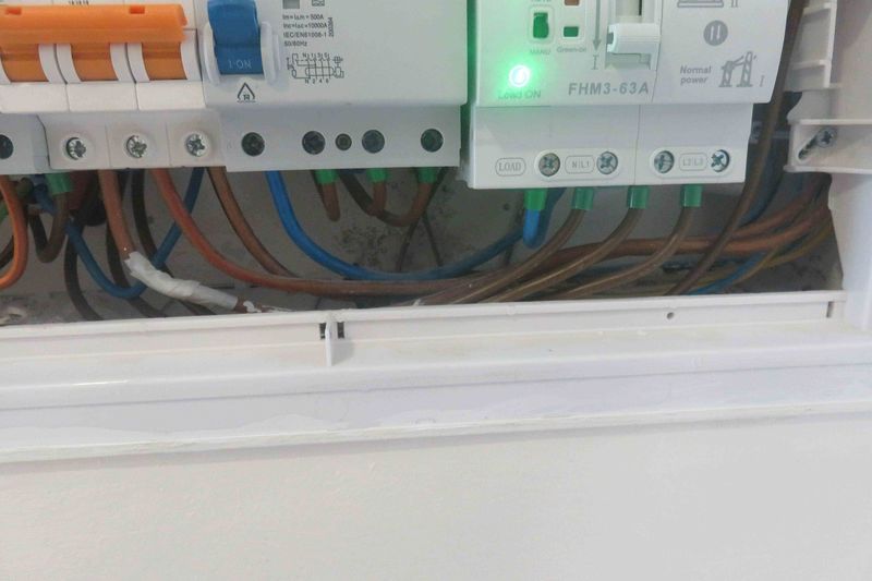

                                          #54
                                          זה הבורר האוטומט עדיין לא מחובר לחשמל

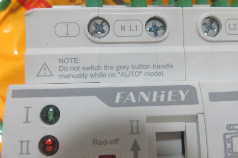

                                          img_2228_optimized_optimized_compressed_800x533.jpg) ![img_2229_optimized_optimized_compressed_800x533.jpg](/assets/uploads/files/1785396600721-
                                          זה החיבורים לממיר שים לב השתמשתי בחום אחד לשליליimg_2229_optimized_optimized_compressed_800x533.jpg) img_2230_optimized_optimized_compressed_800x533.jpg img_2231_optimized_optimized_compressed_800x533.jpg img_2232_optimized_optimized_compressed_800x533.jpg img_2233_optimized_optimized_compressed_800x533.jpg img_2234_optimized_optimized_compressed_800x533.jpg img_2235_optimized_optimized_compressed_800x533.jpg img_2236_optimized_optimized_compressed_800x533.jpg img_2237_optimized_optimized_compressed_800x533.jpg img_2238_optimized_optimized_compressed_800x533.jpg img_2239_optimized_optimized_compressed_800x533.jpg img_2240_optimized_optimized_compressed_800x533.jpg img_2241_optimized_optimized_compressed_800x533.jpg
