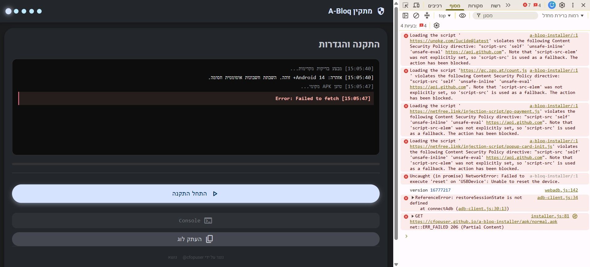

          • cfopuserC cfopuser
            @המתכנת-התותח קצת יותר פרטים,
            איזה סינון?
            לוגים מהקונסול של הדפדפן.
            והאם זה בעיה עבורך רק במחשב הזה.
            שמואל ש.ש מנותק
            שמואל ש.ש מנותק
            שמואל ש.
            כתב נערך לאחרונה על ידי שמואל ש.
            #66
            @cfopuser גם אצלי קורה
            נטפרי
            זה כל הפלט
            Loading the script 'https://unpkg.com/lucide@latest' violates the following Content Security Policy directive: "script-src 'self' 'unsafe-inline' 'unsafe-eval' https://api.github.com". Note that 'script-src-elem' was not explicitly set, so 'script-src' is used as a fallback. The action has been blocked.
            a-bloq-installer/:1 Loading the script 'https://gc.zgo.at/count.js' violates the following Content Security Policy directive: "script-src 'self' 'unsafe-inline' 'unsafe-eval' https://api.github.com". Note that 'script-src-elem' was not explicitly set, so 'script-src' is used as a fallback. The action has been blocked.
            a-bloq-installer/:1 Loading the script 'https://netfree.link/injection-script/go-payment.js' violates the following Content Security Policy directive: "script-src 'self' 'unsafe-inline' 'unsafe-eval' https://api.github.com". Note that 'script-src-elem' was not explicitly set, so 'script-src' is used as a fallback. The action has been blocked.
            a-bloq-installer/:1 Loading the script 'https://netfree.link/injection-script/popup-card-init.js' violates the following Content Security Policy directive: "script-src 'self' 'unsafe-inline' 'unsafe-eval' https://api.github.com". Note that 'script-src-elem' was not explicitly set, so 'script-src' is used as a fallback. The action has been blocked.
            a-bloq-installer/:1 Uncaught (in promise) NetworkError: Failed to execute 'reset' on 'USBDevice': Unable to reset the device.
            webadb.js:142 version 16777217
            adb-client.js:34 ReferenceError: restoreSessionState is not defined
            at connectAdb (adb-client.js:30:13)
            connectAdb @ adb-client.js:34
            await in connectAdb
            onclick @ a-bloq-installer/:87
            installer.js:81 GET https://cfopuser.github.io/a-bloq-installer/apk/normal.apk net::ERR_FAILED 206 (Partial Content)
            runInstallation @ installer.js:81
            setTimeout
            navigateTo @ ui.js:93
            onclick @ a-bloq-installer/:138
            אנדרואיד 16
            עריכה: בסוף הצלחתי עם התוכנה של המחשב

              #67
              @שמואל-ש. גם אצלי.
              מה שמוזר שבקישור הישיר - זה מוריד את האפליקצייה בנטפרי - אתמול בלילה הסתבכתי עם זה הרבה זמן, עד שפשוט הורדתי את האפליקצייה מהקישור הישיר, והתקנתי עם אתר ADB.

                #68
                @שמואל-שץ אני ישתדל להסיר את הcors בהמשך תודה על הפידבק.

                    #70
                    @המתכנת-התותח @שמואל-ש. @האיש-הלבן
                    הסרתי את הcors ועוד מספר התאמות כדי לא להתנגש עם נטפרי אמור לעבוד מצוין עכשיו,
                    אשמח אם תבדקו.
                    (בכול אופן יש לי צד שיש בעיה נוספת אבל גם א"כ היא תופיע כעת בלוגים)
