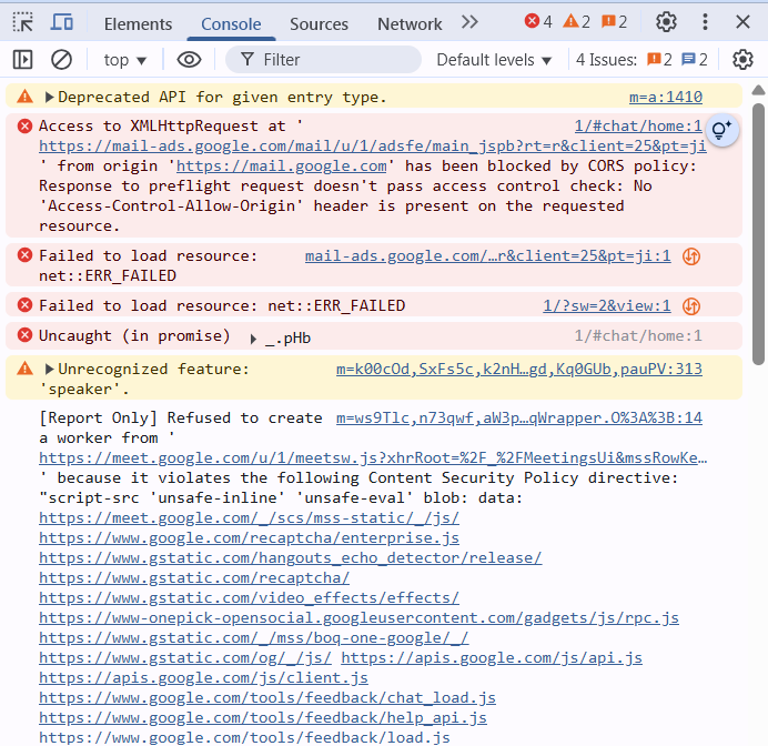

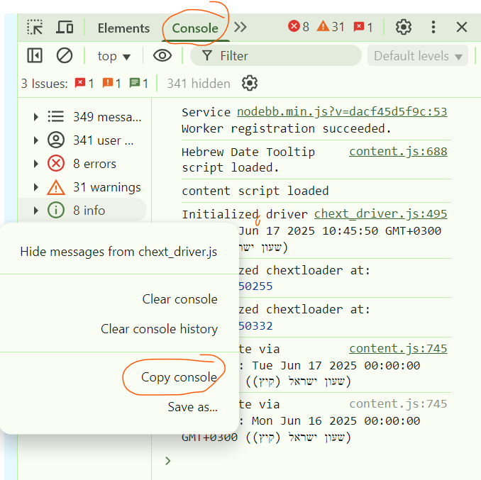

    תלחץ על אחת מהשגיאות בלחצן ימני, ותבחר COPY CONSOLE, ותדביק פה בעיצוב קוד ככה:
    קוד
    אגב, הכרום מעודכן?
    זה בכל חשבון מייל שאתה מנסה להיכנס?
    uyf.activate @ m=a:1410
    1/data?sw=2&token=%5B%22cftp%22,%22dc822e2894%22,%22gmail.pinto-server_20250609.07_p0%22,%22ZyMrc6cBAw-rFZnvtXyj5A%5Cu003d%5Cu003d%22,null,2,%22%22%5D&dilte=0&gme=1&sme=1&pt=ji&di=0:1 An iframe which has both allow-scripts and allow-same-origin for its sandbox attribute can escape its sandboxing.
    1/#chat/space/AAAAZg87RPw:1 Access to XMLHttpRequest at 'https://mail-ads.google.com/mail/u/1/adsfe/main_jspb?rt=r&client=25&pt=ji' from origin 'https://mail.google.com' has been blocked by CORS policy: Response to preflight request doesn't pass access control check: No 'Access-Control-Allow-Origin' header is present on the requested resource.
    mail-ads.google.com/mail/u/1/adsfe/main_jspb?rt=r&client=25&pt=ji:1
               Failed to load resource: net::ERR_FAILED
    1/#chat/space/AAAAZg87RPw:1 Uncaught (in promise) Error: A listener indicated an asynchronous response by returning true, but the message channel closed before a response was received
    m=SxFs5c,k2nH2,WYapUc,y6n3vc,FONIae,Kq0GUb,pauPV:163 Unrecognized feature: 'speaker'.
    PCo @ m=SxFs5c,k2nH2,WYapUc,y6n3vc,FONIae,Kq0GUb,pauPV:163
    m=ws9Tlc,n73qwf,aW3pY,GkRiKb,e5qFLc,IZT63,UUJqVe,O1Gjze,xUdipf,ZDZcre,OTA3Ae,ZwDk9d,RyvaUb,mI3LFb,XU5LFb,m9oV,hl,P6sQOc,QcfBve,mzzZzc,rCcCxc,mSX26d,WO9ee,xzev0d,ArWw1e,O6y8ed,PrPYRd,MpJwZc,NwH0H,V3dDOb,lazG7b,Ivl8bd,g9HNd,XVMNvd,KUM7Z,Fl2dbf,qTnoBf,lwddkf,gychg,w9hDv,RMhBfe,SdcwHb,texUgd,pw70Gc,EFQ78c,Ulmmrd,A7fCU,mdR7q,wmnU7d,xQtZb,FSOnAf,gJzDyc,JNoxi,MI6k7c,kjKdXe,BVgquf,QIhFr,lfpdyf,hKSk3e,hc6Ubd,SpsfSb,Z5uLle,MdUzUe,zbML3c,zr1jrb,Uas9Hd,pjICDe?wli=MeetingsUi.n83heo_MM5s.loadAudioAnalyzer.O%3A%3BMeetingsUi.XUxAAW9Yl6g.loadAudioEncoder.O%3A%3BMeetingsUi.AOGWp6nKaUU.loadNetEqLyraWrapper.O%3A%3BMeetingsUi.L8oFtzl-Qk8.loadNetEqWrapper.O%3A%3B:14 [Report Only] Refused to create a worker from 'https://meet.google.com/u/1/meetsw.js?xhrRoot=%2F_%2FMeetingsUi&mssRowKey=boq-rtc.MeetingsUi.iw.SpMvieD4w_U.2020.O&buildLabel=boq_meetingsuiserver_20250611.00_p1' because it violates the following Content Security Policy directive: "script-src 'unsafe-inline' 'unsafe-eval' blob: data: https://meet.google.com/_/scs/mss-static/_/js/ https://www.google.com/recaptcha/enterprise.js https://www.gstatic.com/hangouts_echo_detector/release/ https://www.gstatic.com/recaptcha/ https://www.gstatic.com/video_effects/effects/ https://www-onepick-opensocial.googleusercontent.com/gadgets/js/rpc.js https://www.gstatic.com/_/mss/boq-one-google/_/ https://www.gstatic.com/og/_/js/ https://apis.google.com/js/api.js https://apis.google.com/js/client.js https://www.google.com/tools/feedback/chat_load.js https://www.google.com/tools/feedback/help_api.js https://www.google.com/tools/feedback/load.js https://www.google.com/tools/feedback/open.js https://www.google.com/tools/feedback/open_to_help_guide_lazy.js https://www.gstatic.com/feedback/js/ https://www.gstatic.com/feedback/js/help/prod/service/lazy.min.js https://www.gstatic.com/inproduct_help/api/main.min.js https://www.gstatic.com/inproduct_help/chatsupport/chatsupport_button_v2.js https://www.gstatic.com/inproduct_help/service/lazy.min.js https://www.gstatic.com/uservoice/feedback/client/web/live/ https://www.gstatic.com/uservoice/surveys/resources/prod/js/survey/ https://meet.google.com/meetsw.js https://meet.google.com/devicesw.js https://meet.google.com/notrodsw.js https://www.googletagmanager.com/gtag/js https://www.google-analytics.com/analytics.js https://www.googletagmanager.com/gtag/destination https://maps.googleapis.com/maps/api/js https://meet.google.com/_/scs/mss-static/_/js/k=boq-rtc.MeetingsUi.iw.SpMvieD4w_U.2020.O/ https://apis.google.com/_/scs/abc-static/_/js/ https://maps.googleapis.com/maps-api-v3/api/js/ https://maps.googleapis.com/maps/vt https://maps.googleapis.com/maps/api/js/ https://maps.googleapis.com/maps/api/place/js/ https://www.gstatic.com/recaptcha/releases/". Note that 'worker-src' was not explicitly set, so 'script-src' is used as a fallback.
    The service worker navigation preload request was cancelled before 'preloadResponse' settled. If you intend to use 'preloadResponse', use waitUntil() or respondWith() to wait for the promise to settle.
    עוד אחד
    m=hfcr:34
               POST https://accounts.google.com/RotateCookies 403 (Forbidden)
    lb @ m=hfcr:34
    nb @ m=hfcr:35
    (anonymous) @ m=hfcr:33
    setTimeout
    hb @ m=hfcr:33
    f @ m=hfcr:32
    (anonymous) @ m=hfcr:32
    הכרום מעודכן וזה בכל חשבון
    @מיישה
    אני מתייג בשבילך את @אלישי שביקש ג"כ לראות את זה.
    אני לא יודע מה הפשט, כל שגיאה מראה על משהו אחר, השאלה אם השגיאות באמת מזוהות נכון.

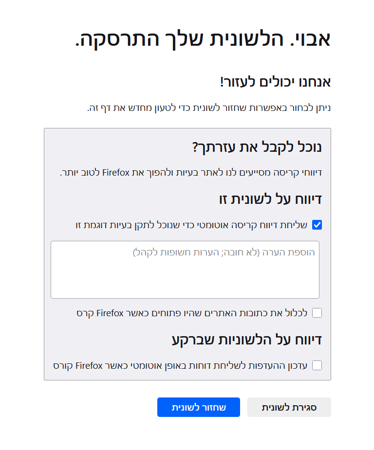

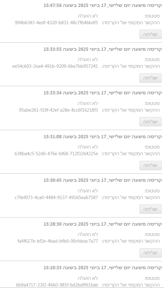

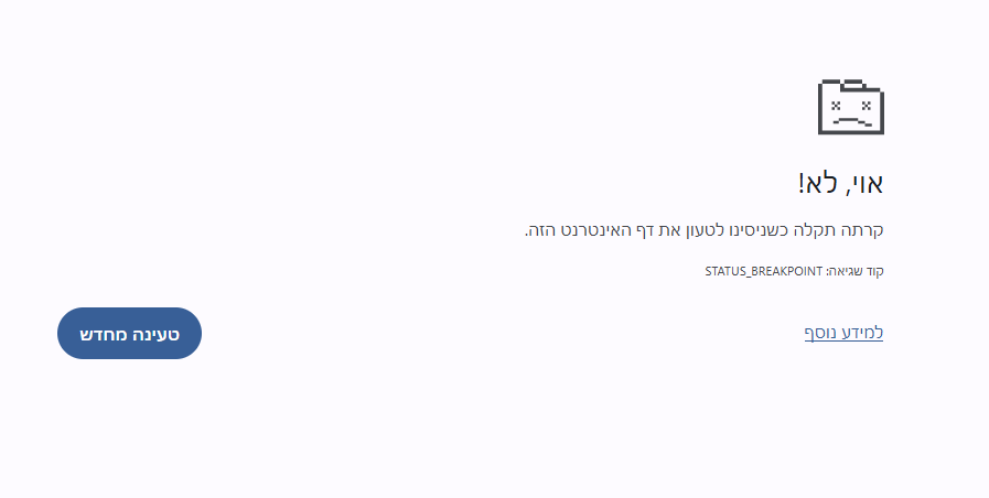

    • מיישהמ מיישה

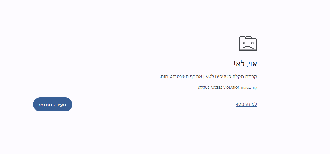

      כל כמה זמן, לפעמים רצוף לפעמים פעם ב, פתאום נתקע לי המסך ומופיע לי התמונה שלהלן.
      כמובן דיברתי עם בזק שהפנו אותי לנטפרי, ולנטפרי שהפנו אותי לבזק, קיצר נפלתי בין הכיסאות ונשארתי עם זה.
      קורה בעיקר בגוגל צ'אט, עליאקספרס והאתר של נטפרי...
      אציין שזה מה שקורה כל פעם בקריסה.
      71c41f1e-e6ca-4692-9259-d30932204238-צילום מסך 2025-05-09 010732.png aa200c4d-07f5-4ed0-a9ad-5d38c025e859-צילום מסך 2025-05-09 011539.png
      תודה רבה!

        רק לעשות פה קצת סדר: השגיאות הנ"ל זה קריסה של תהליך הכרום שמאחורי הכרטיסייה, זה לא שגיאה בקוד JS של האתר אלא שגיאה בקוד של כרום/כרומיום/אדג'
        זה יכול להיות מכמה סיבות:
        • אולי האנטי וירוס מזריק קוד לתוך תהליך כרום וזה הקוד שקורס
        • אולי יש באמת באג בגירסה זו של כרום, השאלה היא למה אנשים אחרים לא נתקלים בזה
        • אולי יש אזור פגום בראם
        • ועוד...
        צעדים לדיבוג הבעיה:
        • לכבות אנטי וירוסים
        • לבדוק על פרופיל משתמש נקי בלי שום תוספים
        • למצוא את דו"ח הקריסה שכרום שומר איפשהו ולנסות להבין משם משהו (עיין chrome://crashes)

            #33
            @yzahn
            זה באמת חייב להיות כך לגבי השגיאות של STATUS_ACCSES_VIOLATION ו STATUS_BREAKPOINT.
            אבל השגיאות שיש בהקלטת תעבורה ובקונסול לא נראים קשורים (למרות שאף פעם א"א לדעת).
            בכל אופן יכול להיות שבאמת השגיאות שבקונסול הם סתם משהו שקורה לכל אחד מידי פעם ואפילו לא שמים לב, ומה שתוקע את הכרטיסיה קשור רק לתקלה שבדפדפן עצמו.

                    @אלישי
                    תודה.
                    כמובן שהשבתתי את האנטי ווירוס ולא עזר, בפיירפוקס זה פשוט מטורף, כל שנייה זה קורס!
                    שלח מייל ל- gmhhassimot@gmail.com
